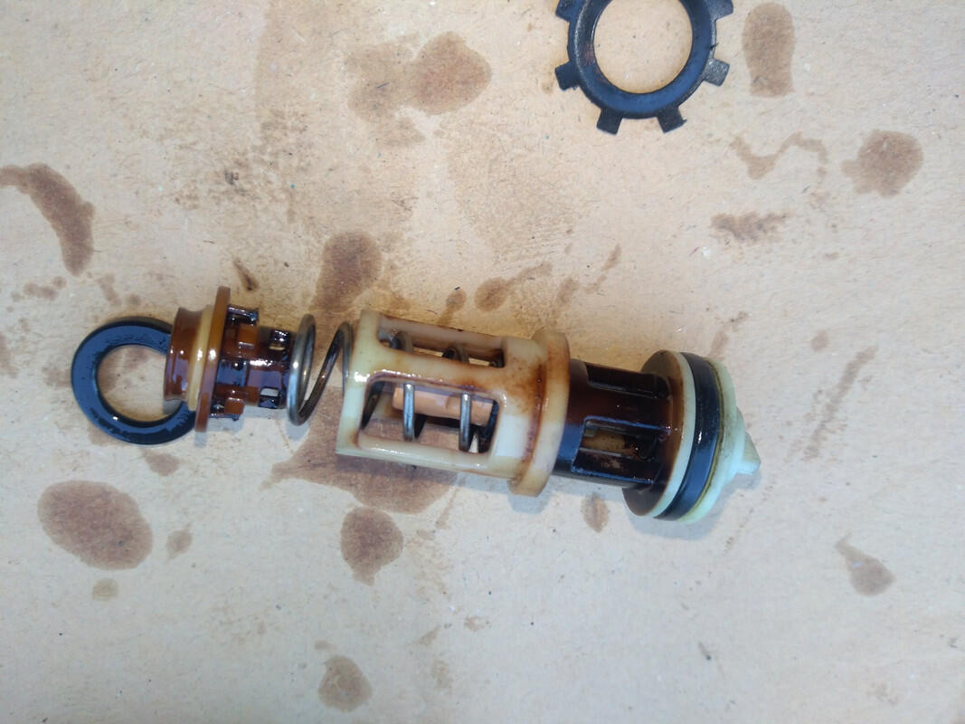

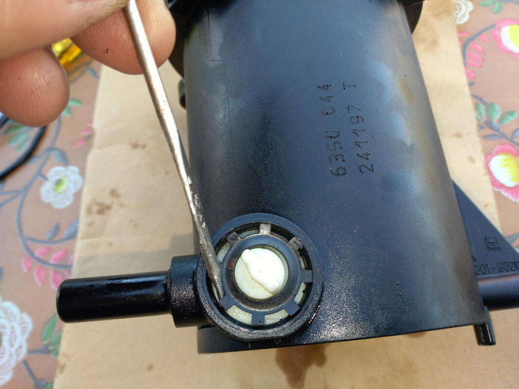

Beim Dieselfilter ist es üblicherweise die Vorwärmung unten im Gehäuse die Luft zieht, das kleine weiße Plastikding. Einen Satz O-Ringe plus Sicherungsring gibts für 'nen Zehner, dann funktioniert das wieder ohne Lufteintrag.
Change the O-ring on the thermostat and definitely on the filter housing.
When it's cold, fuel starts leaking, the engine starts for 5 seconds and then shuts off, then you have to start it again 2-3 times until it draws fuel and starts working normally.

vor 1 Stunde schrieb gasa:
large.IMG-20240203-115407.jpg.3c48727a7ad038249159911c18a5e060.jpglarge.IMG-20240203-115845.jpg.836215dba84c7b23119cdf02582f31f4.jpglarge.IMG-20240203-120946.jpg.eab9d6ca1203947328ea65f960776a7e.jpglarge.IMG-20240203-121218.jpg.ae01a05ca4c2bd53965cf8b16bf51495.jpglarge.IMG-20240203-121018.jpg.3eb99e2736cdd207b450f3e62b6d85f8.jpglarge.IMG-20240203-121029.jpg.3e723166bf30b1a09a25c2136f537381.jpglarge.IMG-20240203-120244.jpg.2f63fa4582dff3d8c68819db84976e10.jpglarge.IMG-20240205-162306.jpg.b21febe643ce100f4da3e68d086291ff.jpg
Thank you, but I’m afraid that’s not the problem. I had this behaviour some ten years ago. Unless I pumped diesel before ignition the engine started and then shut off. The EPIC back then was sealed professionally, and it has worked fine since then.
Today the problem is that the car starts and drives nicely, but shuts off unintentionally while waiting on a traffic light. It starts again immediately and works properly then — for a while.
